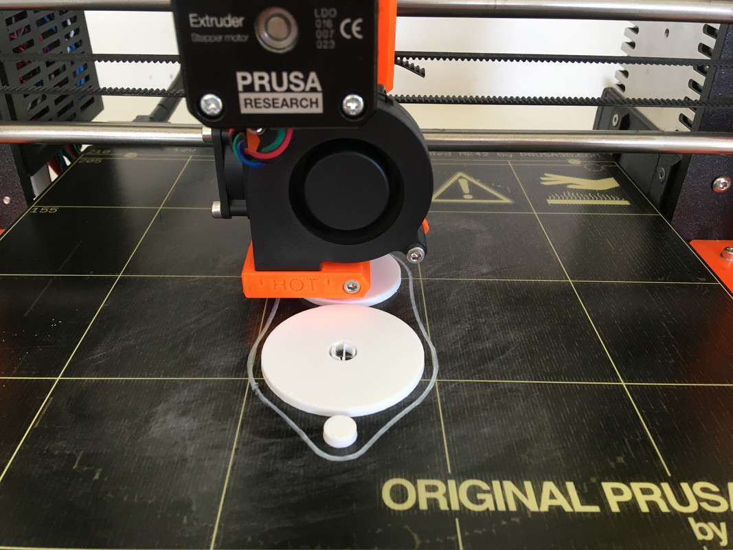

Yes, when you think that for £650 Omega will refurbish your banged up watch and return it to you 'like new', £300+ for a crystal seems a little rich. What is interesting about this is that the gasket is bespoke. You cannot buy a .5mm I-ring. My research tells me that the ideal 'Shore Hardness' for gaskets is 72D which means they are almost certainly made from DuPont Hytrel 7246. If I could source the Hytrel pellets I could 3D print bespoke gaskets.
Share this post
Link to post
Share on other sites
What type of gasket do they use ? Is it L shaped then ? Because you can find a variety of gaskets on Cousins... Even so you have the original one which I imagine is alright.
Share this post
Link to post
@gimli You can't find these gaskets at Cousins or anywhere else. It is in I-Ring for a 1.5/6mm crystal. 1.25mm High X 0.5mm thick. There for the actual size of the Glycine gasket is 37.3 X 36.3.  The closest you can buy 'off the peg' is 37.3 X 36.5 which is a standard 0.4mm thickness.
When fitting a crystal you need to find a gasket that is 0.1 or 0.2mm smaller than the crystal.
If I had used the 'off the peg' gasket I would be relying on the 0.003 oversize in the crystal. It would have held...just but would probably fall out over time and it would certainly not be waterproof.

@WRENCH Hi Wrench, after 10 years or so learning how to repair watches (in-between bringing up kids and running other businesses) I have accumulated quite a bit of kit. I had an idea that I could make watches and I invested in Sherline CNC Mill and Lathe...but I really struggled with the 3D and was running before I could walk. I sold it all and I bought Watch Balance tools and a 3D printer. As the kids have grown older I have had more time to learn 3D design (TurboCad for Mac) and I have improved my watch repair skills.  I can now service almost anything.  The kit sits in my studio and I visit it as often as I can.

I have also just discovered that DuPont make a Hytrel 3D printing filament with a Shore Hardness of 60D....not quite the 72D that a Swiss manufacturer recommends but  it would be worth trying and would probably mean printing gaskets a few microns thicker.
I am also thinking about making a Tampon Dial printer as I have recently completed a Silversmithing course that included an introduction to etching.
What I am finding is that all this stuff is relatively straight forward and there is more than enough information on the WWW to fill in the gaps. The problem is that the equipment is expensive witch makes tabling and experimenting difficult.
The 3D printer has opened my eyes to a lot of possibilities
